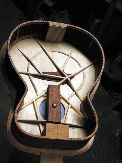

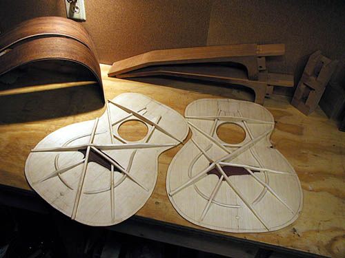

Dennis L mentioned that I use a top bracing system that I have developed. This is something I started working on a bit over 4 years ago in responce to a request from one of my wood customers. It has gone through a number of iterations, but the present state is about what I consider pretty final. I will not go into a lengthy explanation for now, but can attempt to answer any questions later. Here are a couple of braced tops (pretty much OM size):
All bracing is spruce. The curved ones are made from bent laminations. You can ignore everything above the soundhole. That is specifically set up for my adjustable neck system. That part can be standard steelstring bracing. I have mostly done this development using my own white spruce to keep the variables down to a minimum. Not sure what it would do with other spruces or cedar. Since white spruce has a very high crossgrain stiffness, something like sitka might turn out considerably different, I don't really know. I get a really loud, but well balanced sound from this and a pretty well "played in" sound right from the git-go.
If anybody is interested in trying this out, have at it. I will assist as much as I can.

looks interesting for sure. Looks like a lot more braces than I like to use (mass wise), but hey if your getting results then go for it!

Run!!! It's spruce spiders from outer-space!!!    Seriously though, thanks, Grant, for sharing those photos. It's always encouraging when someone steps outside the standard borders, and gets good results.

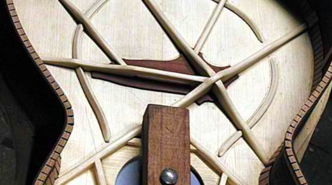

There are two things about your top bracing that I find intriguing. One, your X brace is off-center toward the treble side, which I'm thinking probably improves the highs because this is the area where the top will be the stiffest. Two, you have a lateral cross brace at the saddle line, running from the crux of the X, which serves to stiffen the entire lower bout. On the classicals I've built with a cross brace that runs under the saddle, I've noticed an improvement in sustain over other bracing designs I've used.

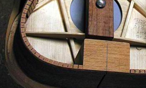

in this picture you sent me a few months ago I noticed an empty space in the transversal brace under the saddle: are you leaving room for the bridge pins or is it intended for a pickup?
The upper bout bracing recalls the powerful "A" bracing seen in some old Martin now reintroduced in some models; the upper part of the "A" crosses the upper bout brace but doesn't touch it am I right? Does it end into headblock channels?

This one should show the under-saddle transverse brace particular...
and the room left at the upper bout crossing. Hope this helps understanding my question.

I recognize that this looks like a lot of mass. But it does not seem to be in actual function. I generally use white spruce sapwood which has a low density, but a high strength.
Luigi, the transverse brace is located precisely under the bridge saddle, so the bridge pins go behind it. The space is to allow for some styles of pickups.
The "A" at the upper end does not contact the transverse brace, it passes through cutouts. The ends are notched into the headblock (actually the headblock is notched to fit over the upper ends of the braces). The upper transverse brace is smaller stock, 1/8" wide, because on my adjustable neck systen the fingerboard extension is not glued to the top. It is supported by an extension of the neck, which you can see on the two neck blanks in my first photo. There is a cutout in the top for this, so there is no downward pressure on the top.

Grant--what are you trying to accomplish with the curved (laminated) braces?

The curved braces - OK, first I have to tell you that I am a stubborn German and do not listen to anybody
One thing that I do (among many) is flintknapping, making stone tools. This is a craft that involves shaping of a piece of stone by applying energy at a point source and having a precise and predictable pathway for that energy (shock wave)to travel through the stone and detach a controled fragment. Besides the point of impact/pressure, the primary controling factor is the surface configuration of the stone. One utilizes the small ridges on the surface of the stone for this control. The ridges are pathways of increased mass and the energy will follow these ridges at a higher velocity than it does the intervening lows. It then spreads laterally from these ridges. The result is that if the ridge curves, the detached flake is curved with the ridge down the center. If the ridge forks, a forked flake is detached, etc. Hope you can follow this.
So, the curved braces (mostly about 1/4" tall and triangular in cross section) are my attempt to duplicate this effect. Does it work that way in wood? I really do not know, but since we are dealing with physics of solids, hopefully there is some similarity. The instruments with these tops do have a very fast responce and very clean tone and are very loud. Perhaps the curved braces are one factor.
